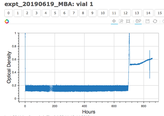

I’ve been running an experiment for ~850 hours, and for the last ~100 hours about half of the vials stopped back-diluting. I had not touched the machine for over 50 hours at that point. I’ve turned off-and-on the turbidostat and router, and restarted the python script multiple times, but only one of those vials began back-diluting again. Has anyone encountered this? If so, do you know what might have gone wrong/what helped you fix the problem? I’m totally stumped.

Assuming you’re running turbidostat mode, if the cells are very dense, and OD values are NaN (likely the case if they haven’t been diluted for 50 hours), then dilutions will not trigger even when restarted. You can manually dilute (using fluid_test or electron app to run pumps) and once OD values return to measurable levels, then automated dilutions will kick in (often over diluting due to backed up pump commands).
Not sure why dilutions stopped in the first place however, would need some more data as Brandon mentioned.
There’s a sudden spiky drop, which looks like it happened within the last day (I’m guessing one of the times I re-started). If I look at the OD text files, they also look like 0.6, not NaN values. The sudden spiky drop at ~830 hours makes me think that the pumps are still working.
Here’s another one of these problem vials - I thought it started working again yesterday after turning the machine off and on, but the OD’s started to climb again.

I think I figured out the problem, actually! It seems that the tubing was fraying around the connectors from multiple media bottles, and those were the bottles corresponding to vials which had stopped back-diluting. I cut off the frayed part of the tubing and re-inserted the connector barb, and the back-dilutions resumed.
