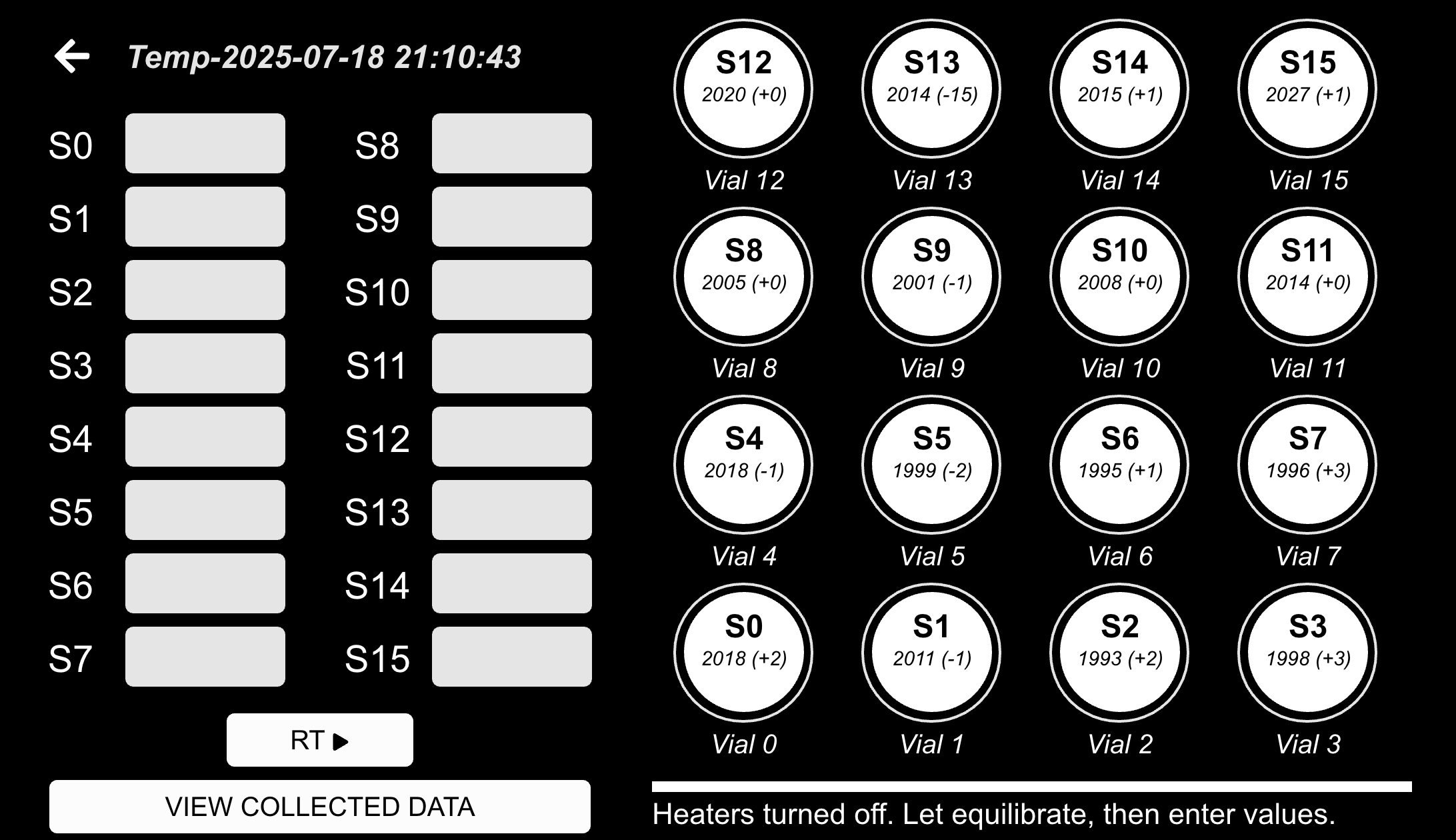

I regret to hear that you’re dealing with some issues. More screenshots or information would be helpful for debugging. More is better. Here are some questions to help debug:
  • Does the serial communications work? In other words, does it work when you start and stop stirring? Or actuate the pumps from the GUI?
  • You said the temperature is climbing, to what? 50C? Or something lower? Does it stabilize? How does it behave if you set the temperature manually in the setup screen (not in the calibrations). This will tell me if there is feedback at all in the system or is there something wrong with the temperature sensors.
  • what us the raw readings you see on the vials? Hit the RAW button on the setup screen to toggle to raw readings.
  • Do you see the proper response? See below. If not, the signal isn’t going through:

Confirmed the communications are working. See screenshot above for raw readings.
