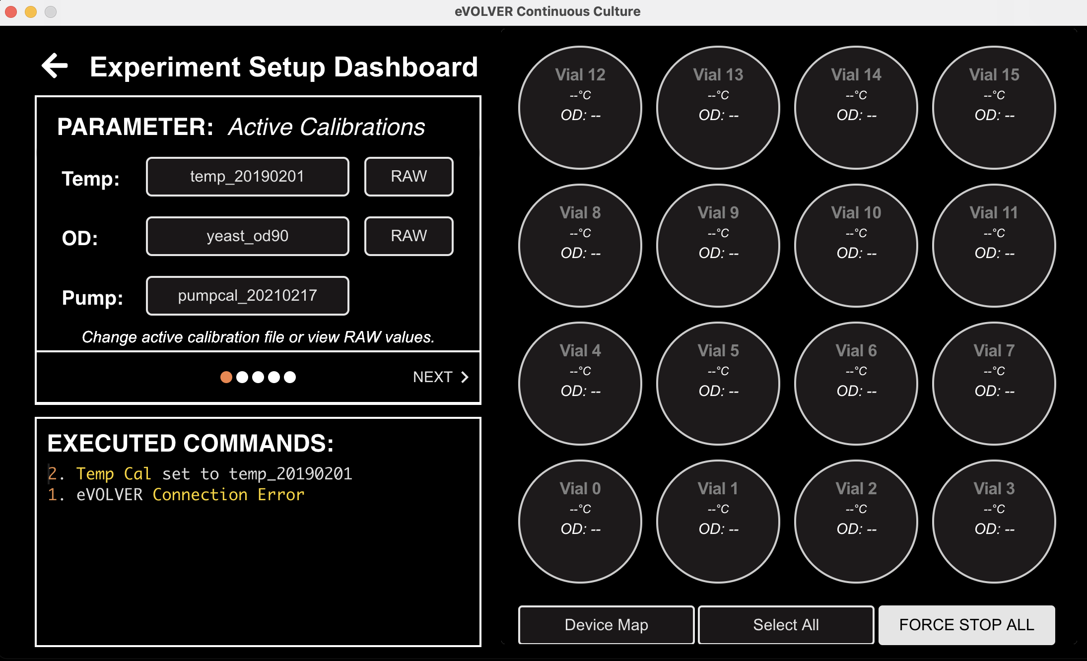

and on both eVOLVER and Mac GUI setup page, the calibration files that could be chosen from have different names:
