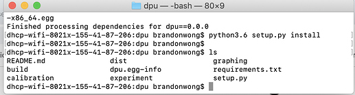

If you are in the correct directory, there should be a script named setup.py in the directory. List the content of the directory using the ls command.
Run the setup script to install the dependencies:
python3.6 setup.py install
That’s it! You are now ready to run your first eVOLVER script!
