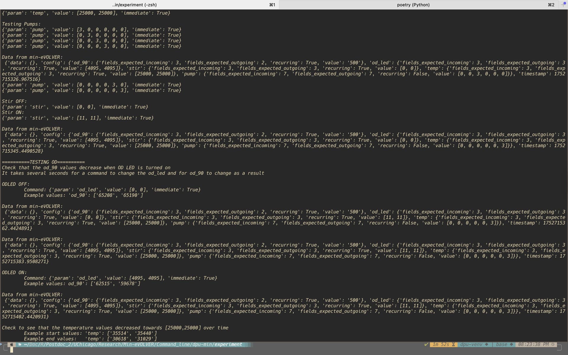

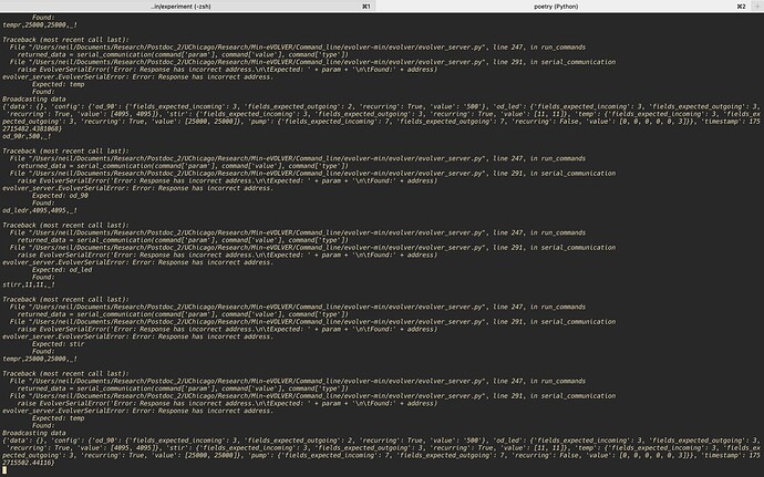

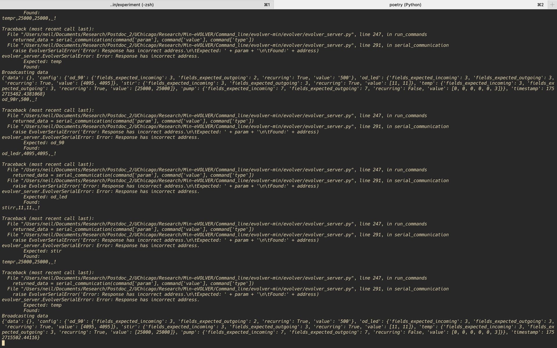

I’m attaching the screenshots from both env for your review.
It is working after we reloaded the arduino code. Thanks for help!
