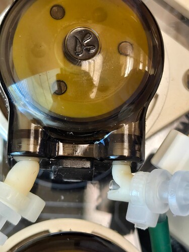

Hello, the tubing on one of my pumps tore (see pic) and I’m wondering how to go about replacing. First, what are the specs on the tubing so I can order a replacement? Second, what is the best way to disassemble the pump?
Thanks in advance.

The tubing is 2mm inner diameter x 4mm outer diameter BPT.
Here’s a couple of possible options to buy some: option1 option2.
To replace the tubing, twist the pump head until it unclicks, then pull it off. You can then remove the broken tube, cut a new tube of the same length, and add the connectors from the old tube back.
