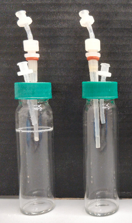

Are there best practices to avoid formation and buildup of bacterial biofilm during an eVOLVER experiment? I have tried adding 0.01% tween 20 to the media (as suggested here), but I still got significant buildup in a handful of E. coli strains.

For E. coli, we had someone test out Tween and PEG media additives, and found that Tween-20 at 0.1% did significantly reduce the biofilm formation. So I might recommend increasing the amount you’re adding up to that concentration.
I’ll also note that stirring may have an effect, and increasing the rate, or using larger stir bars may help.

I can confirm that tween20 0.1%, stir rate 10 and the bigger stir bars seem to inhibit buildup of any visible biofilm after ~70 hours of chemostat growth. Vial on the left had 0.01% tween20, the one on the right 0.1%.

Hey I’m new to the forum, but this echoes my previous results, where 0.1% tween-20 abolished my biofilm issues with mutagenic e.coli.
I also tried minimal medium, a different undefined broth (MHB), and PEG-2000. Those last two actually made the problem worse! (I think my preparation of minimal medium had some solids in it, which nucleated biofilm formation… probably a preventable problem)
I may perform a quick test to see if 0.1% can be tamped down to 0.05% or so, as in the paper you linked, 0.1% has a significant effect on growth.
