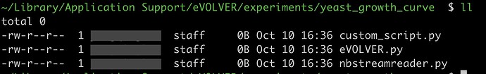

I found, after i created a new experiment on Mac GUI, the generated files custom_script.py, eVOLVER.py and nbstreamreader.py in folders /Users/<my_name>/Library/Application Support/eVOLVER/experiments/<my_experiment_name>/ and /Users/<my_name>/Library/Application Support/eVOLVER/template/ are all empty. below are the screen shot.
When you first opened the application, did you have an internet connection? If not, connect to the internet, delete those directories manually, and try again. I’ll make an issue on github to have it check for the files and alert if it can’t access github. You can also manually put the files in place for now. As long as you put the .py files in the template directory everything should work.
Thanks so much for your help. Your suggestion of connecting to internet fix the issue that i got empty files in folders template and experiments/<my_experiment_name>/
