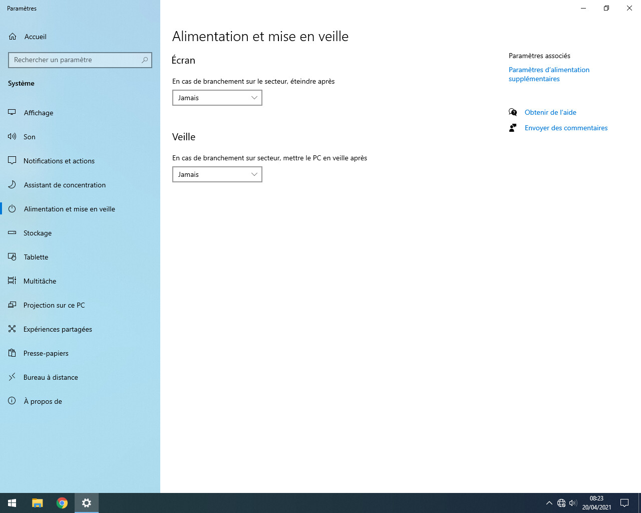

This is strange. This is typically caused by the computer going to sleep. Can you screenshot the power settings you have on your computer and share it here?
Brandon
It is in French, sorry… The sleep (veille) option is actually set to never.
Can you give me more details, is this going through a private routers or the university router? Can you elaborate on what you tried? You were trying to go through WiFi before?
Before we used the wired network of the university. This was done with my laptop. The first thought was about computer falling asleep, so I tried disactivating ‘sleep option’ when connected to power source. The problem didn’t disappear.

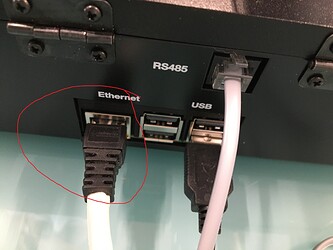

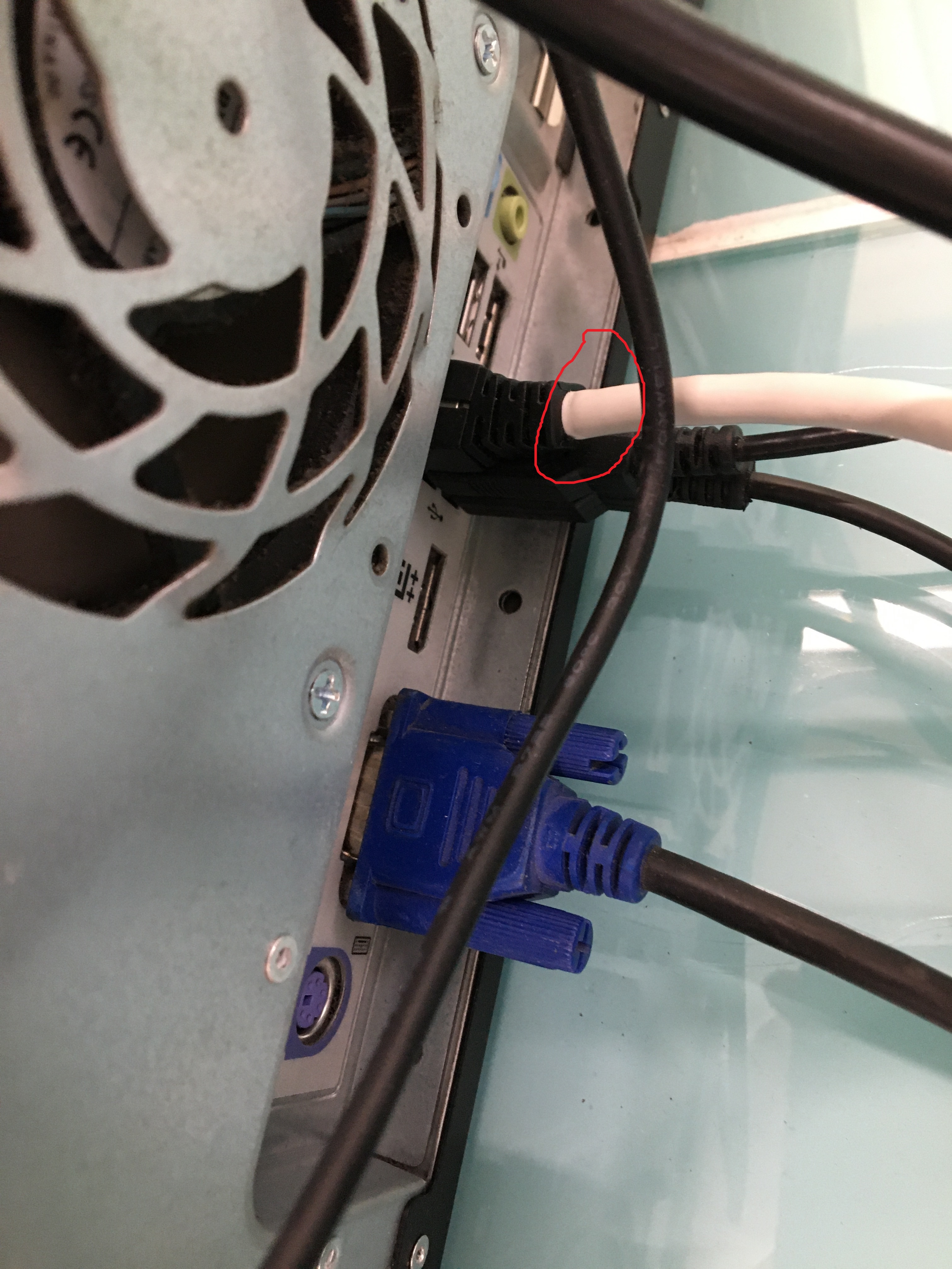

We thought that the problem was with the university network or maybe with antivirus of my laptop, so we tried connecting evolver to a lab computer that is in the same room directly by an ethernet cable. We cannot use WiFi connection for lab equipment.
The evolver got an internal IP attributed by Windows of the lab computer (169.x.x.x).
This decreased significantly these periods without data (Just once in 3 experiments). But still this happened.
